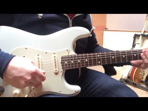

DO THIS MOD!!!!
I bloody love it. I have tried to do a before and after video but I think I've messed up the recording of the audio/video so I'm gonna try and salvage it. If I do I'll try and post something here.
But for now, it really is a great mod. Its very hard to explain exactly what it does but if your complaining about your bridge s/c pickup being thin or weedy on your strat then this is the cheapest and easiest mod for you.
When I was mulling it over @richardhomer described it as similar to a vintage tele sort of vibe? I'd agree with that. Ive played teles solely for years and have since fallen for the "comfort" of strats at gigs. This mod puts me in the same sort of ball park sound wise as well.
I got mine from Oil City Pickups and it cost about £4 or so + postage? (dont quote me on that!) sure it goes without saying but service from them was top notch.
hopefully ill try and get the vid together soon because I put a bit of effort into sorting the sound out. in the meantime thanks to @TheGuitarWeasel for the service and parts and @richardhomer for the tips and advice. Both stand up gents....
EDIT: The activity on this blog made me pull my finger out. So here it is in all its mic clipping, out of sync glory TEH DEMO!

    now with added demo!
    How very rock and roll
  • OilCityPickupsOilCityPickups Frets: 12001
    Thanks for putting up a demo geezer :-)

    @TheGuitarWeasel Yeah apologies I got the price wrong in the vid. Either way its a stupidly cheap mod for great results. I have a tonne of gigs coming up over the next month and I cant wait to see how it soudns at gig levels.
    I was going to wire the tone pot to the bridge pickup but im not even sure its worth bothering now I have the baseplate on!
