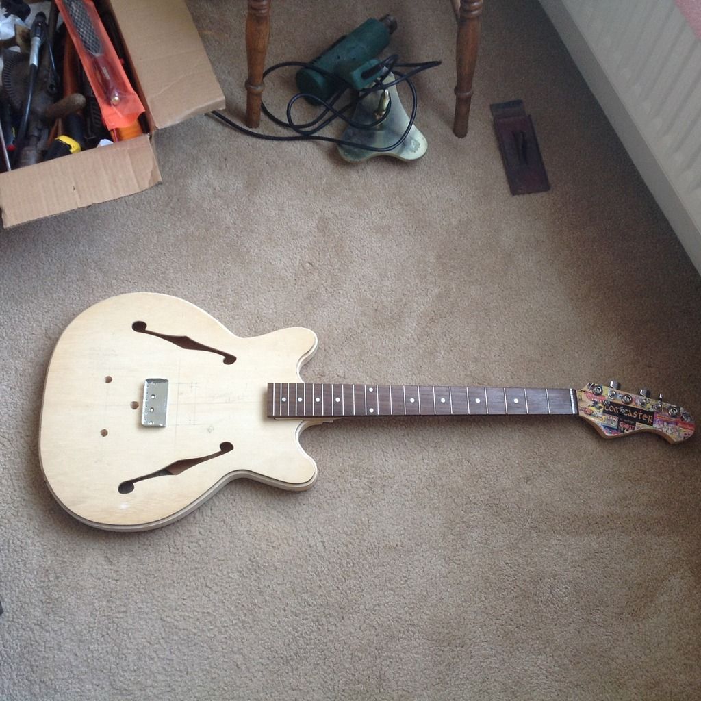

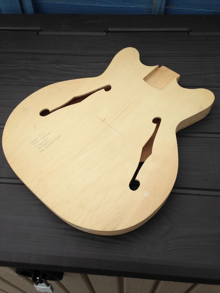

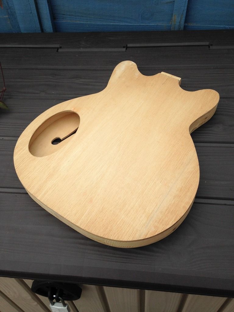

I got this tryuly awful body off someone on here, it was cheap, for a reason,
 I was going to put an Epi EB-0 Short scale bass neck onto it and had to fill the 3 point bridge holes I had already drilled…then I had to cover it all up somehow, so thought a while and took a cup-o-tea to the pink one in the sewing room, Eureka moment, she released custody of a "Fat Quarter" of fabric, so I Gorilla glued it onto the top of the body…
I had also routed a recess around the edge of the body previously too

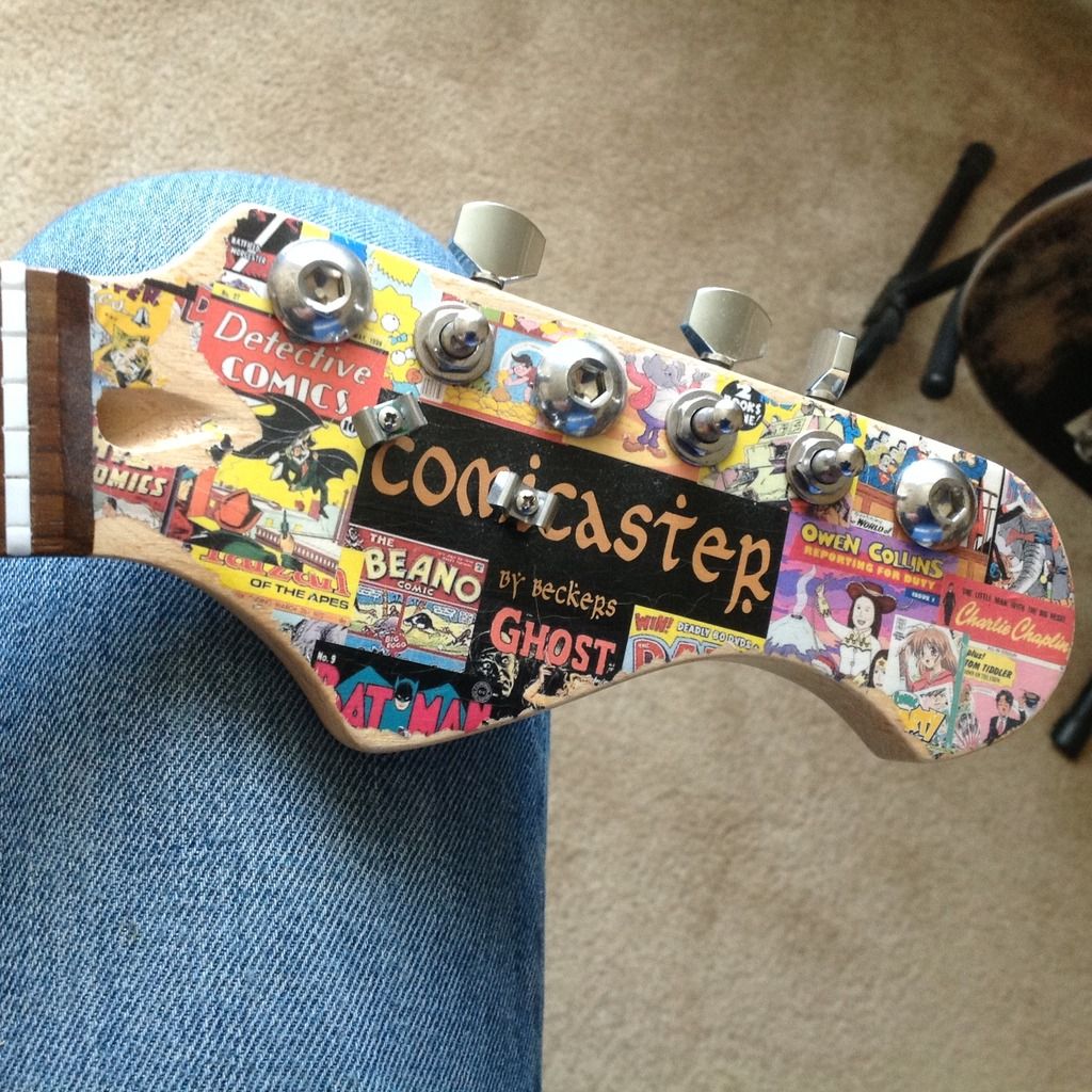

The neck I removed from a previous ratty project 3 string Comicaster

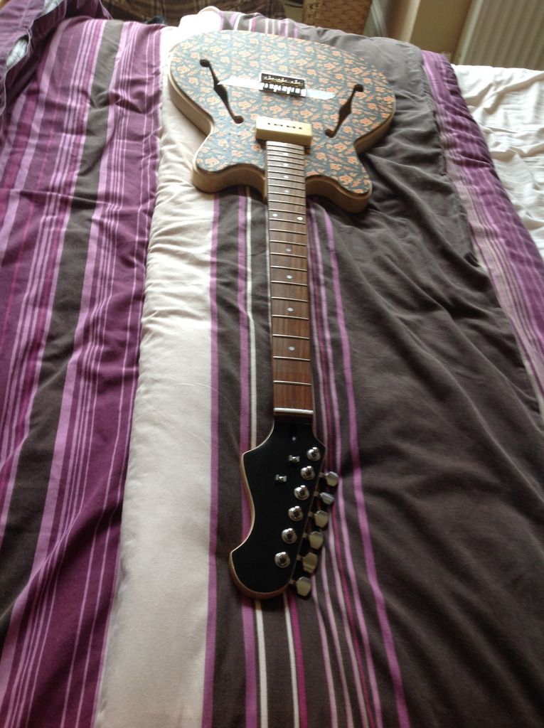

So today the headstock is sprayed satin black, tuners and trees install, neck holes drilled and neck bolted on….

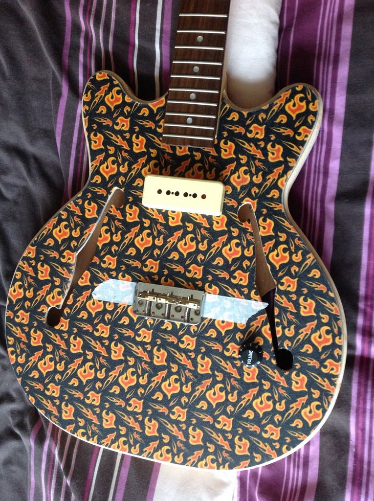

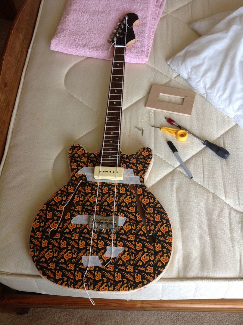

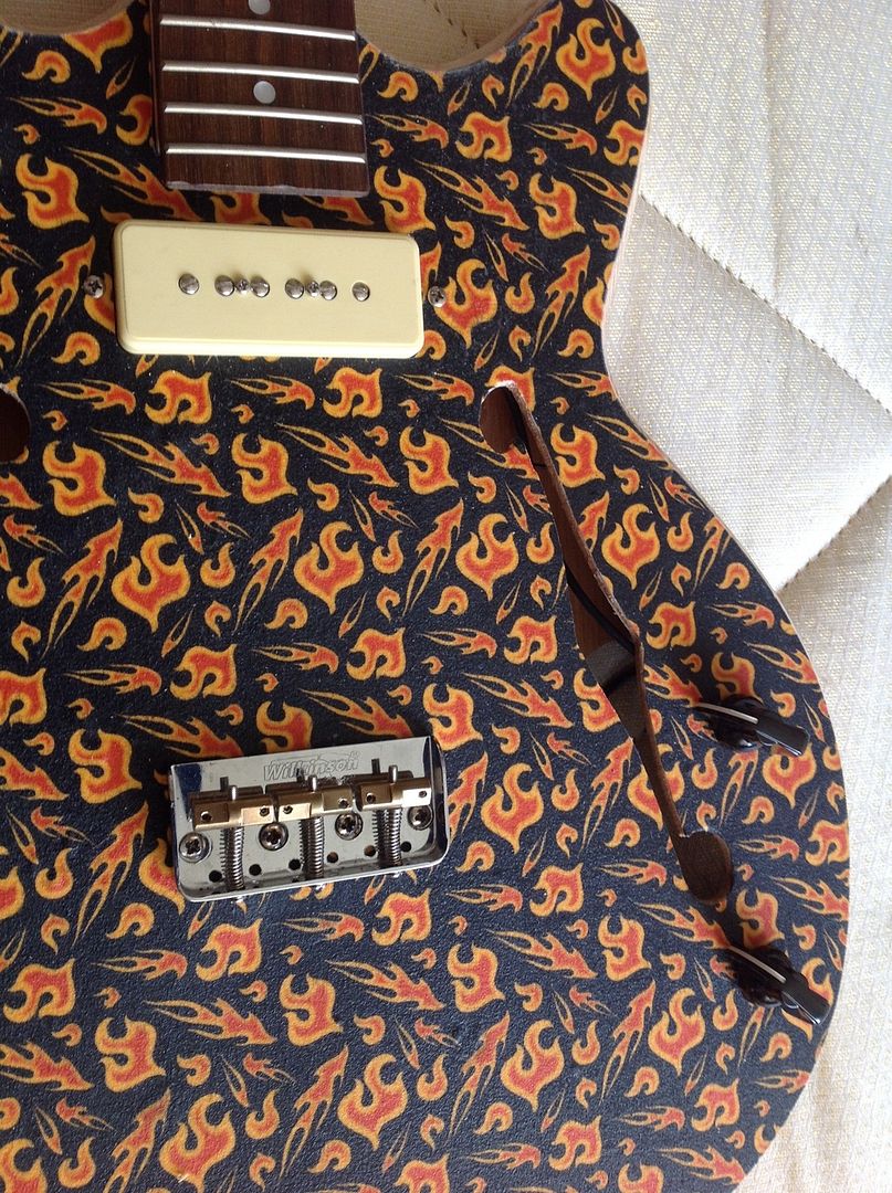

    Had quite a good day today amd although chilly it meant I could get onto the deck and do a bit, but first locate the bridge using a couple o bits o string and a tape measure, this saw the bridge located and temporarily fitted....

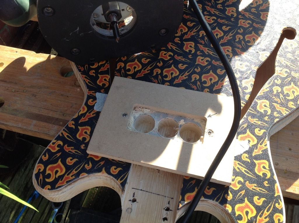

    Then apply some masking tape to the area where the pickup route would go, located the P90 pup cover, drew round it then secured the template with double sided tape and a couple of screws, using the screw holes for a dogear P90 that is too expensive for the challenge, but will probably be fitted after the challenge.....then hog out some of the waste with a Forstner bit.....
  • paulnb57paulnb57 Frets: 3093

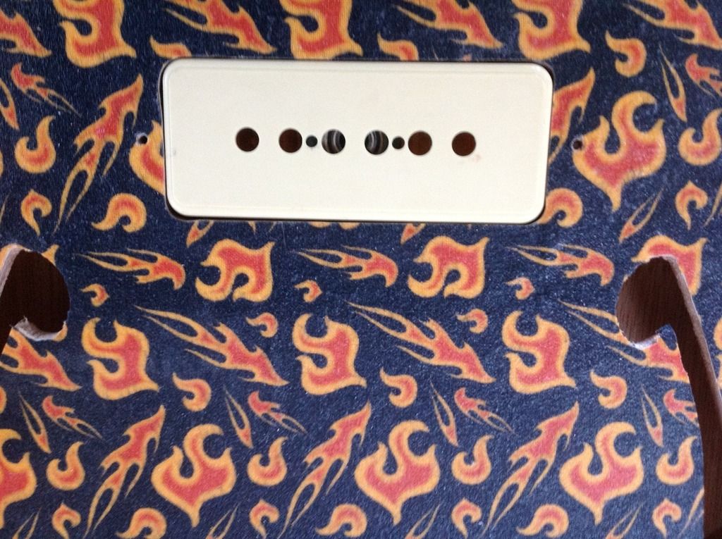

    I didn't have a router bit of the right diameter that had a bearing so I hogged out deep enough that the shank of the router bit could run on the edge of the template, took it really easy with very many tiny cuts until done...Christonabike, it looks like a grown up did it!
    Neighbours will think I'm a mentalist cos I wooped and tried to high five the Bastard (dog)...this is the first time I have tried to do a pickup rout, so well chuffed!
    Then drill d a recess under the bridge with a forstner then a 1/4 inch drillbit for the bridge earthand pickup wires to go through to the control cavity, also drilled the holes for volume, tone and side jack.
    Installed some ratty old pots, the pickup, and an earth to the bridge, the refitted the bridge and some chickenhead knobs from the parts box...
