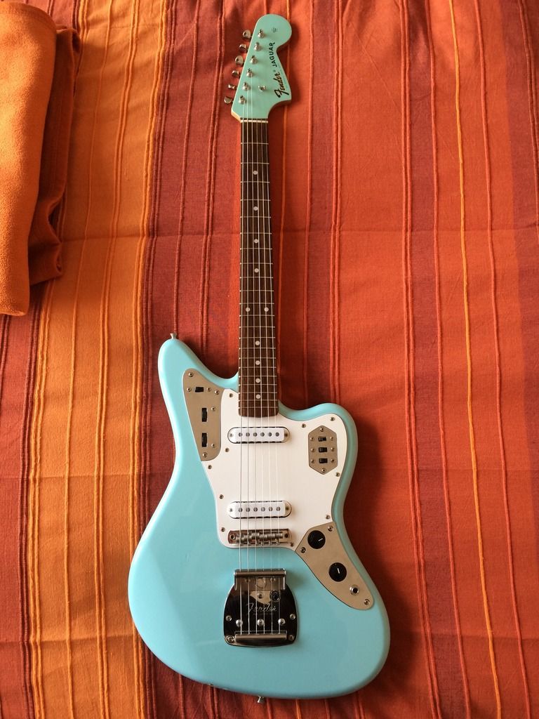

Have had this guitar for a good while now and whilst i've always loved the look of it, it has never really played, or sounded right for me personally.
I'm very lucky in the fact that I was given this guitar by an incredible friend and as such it only seemed right to try and accumulate parts to replace the week links.
I've been amassing the parts for a little while now and finally found some time on Friday to get to work.

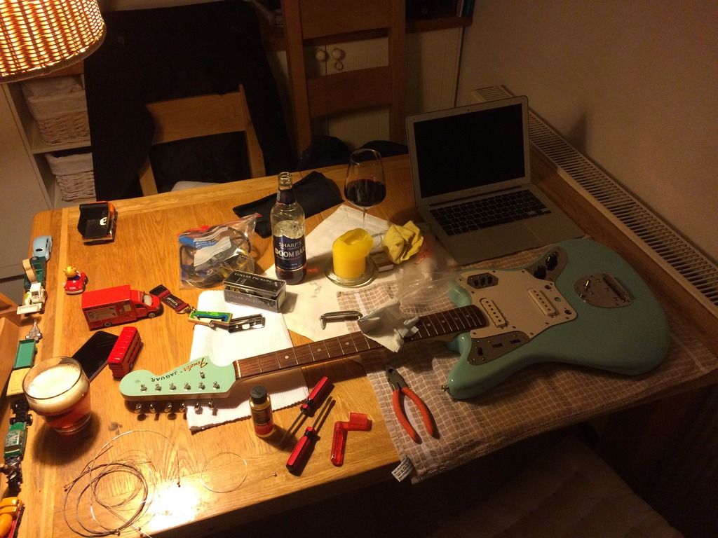

Friday night:
All parts were secondhand and supplied by the fine frequenters of this very parish: Pickups are a set of Lollar for Jaguar from @andrewaward
bridge is a staytrem from @jellybelly and the buzz stop is from @meltedbuzzbox. all superb to deal with, thank you again chaps! :)
After a couple of hours, of, well mainly drinking red wine if i'm honest, the result was this:

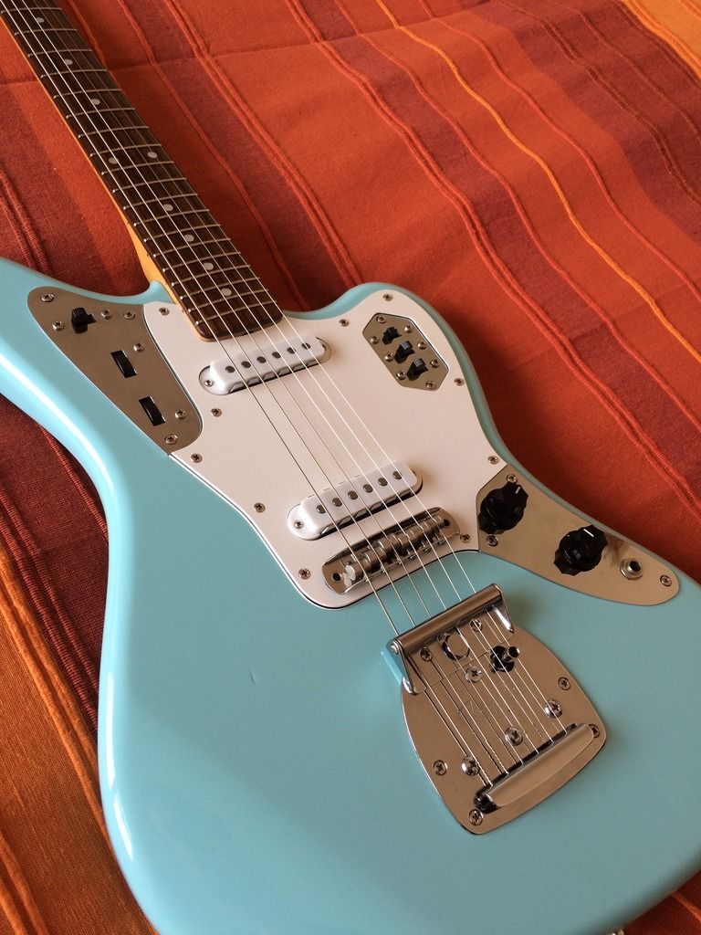

I managed to plug it in for the first time briefly this afternoon and have to say that, unsurprisingly, the pickups sound fantastic. the bridge is a huge step up from standard, & much better than the mustang bridge that I had previous added. The buzz stop is great for increasing break angle which is really all I wanted it for. All in all very happy.
Next things to do are to replace the pots as they are pretty poor (or better still all the wiring and switches with better quality ones, does anyone do a drop in loom for Jaguars?) and i'm still looking for a tort pick guard as well.

    looks good sir.
    I wouldn't tort it though, it looks great as it is. I really like that daphne/sonic blue.
    The jap switches (I am guessing thats a jap model) are actually great, the sit taller than the switchcraft ones.
    I personally prefer them.
    I wouldn't worry too much about replacing all the wiring (maybe the pots(maybe move to 500k))

    I know the tort guards are marmite on a guitar of this colour and I might well agree once I have one to try. I'd still like to try though ;)
    Yep Jap this one. & looking at 500k pots now :)
    Someone had previously fitted what I guess was a strat pickup of some kind in the bridge position too but they had routed the body (by hand, very badly!) to make it fit.. poor thing.

    You probably won't be able to buy a Jaguar loom, it's a massively complicated thing.
    Just change the pots and the jack - the switches are actually quite decent, and with a MIJ ones you can rewire them to give both pickups in series instead of 'both off', which is a very useful extra sound, as well as avoiding the accidental-mute probably when in full thrash mode ;).
    You will have to ream out the plate to take full-size US parts, and you'll need new knobs - those MIJ ones look nasty anyway, when you're familiar with the real ones. (Get plain-shaft pots, which the proper knobs fit on.)
    The roller pots are fine, don't bother changing those either.

    Good shout on wiring to series. Makes a lot of sense.
    Also agree on the knobs. I've got some genuine 60's jazzmaster ones around here somewhere which will go on when I find them!! (And replace the pots) :)
