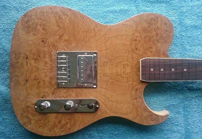

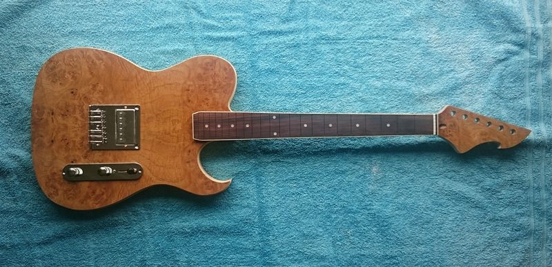

  • Has it started as a Tele project and then mysteriously changed to a Strat? Different photos suggest different body shapes!! Keep it Tele. Spend some time getting a Tele headstock shape. Sell to me. Job done.
    I reshaped the cutaway and filled the neck pickup pocket before veneering. I love the tele shape, I owned a 72 deluxe about 10 years ago and wish I'd kept it, it was actually a Squire body and genuine fender tele neck and it was lush but I mainly play RG's these days and I like the pointy bits. :)
    The strat body is randella's.

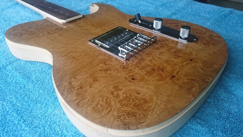

    I think just oiled would look fantastic. It's a really nice piece of veneer. Great job on the headstock :)
    I've been experimenting with inks all yesterday and I'm scared of ruining a nice veneer so I think oiling is the best option.
    Any suggestions on oils, tints etc?  This is all new to me so any advice is good advice.

  • Ok, a few updates and probably a few questions.
    I've pulled a little off the neck, I'm a big fan of the slim D shape and this was a C(?), I was a little scared of going too far without knowing how deep the truss groove is.  I might brave it and take a little more off the middle.
    I had to grind, file and sand down the cheapo fret pullers as they were unusable and didn't nip the frets. Hendrix (our cat) helped.
    I had a little bit of tear-out, what do you guys use as a filler for rosewood?
    The inlays are coming out, I've never been a fan of the dots and all my RG's and acoustics have no fret markers (personal preference I guess) and I'll replace them with something a little more fancy when I find and can afford a good router base for the Dremel.

  • That headstock shape rocks mate. Cool as anything. I have a question for you: is it difficult to shape a neck? I have a jazz master. I built from similar kit, the neck is a bit of a handful and I've bought the same cabinet type scraper you have but never had the courage to attempt it.
  • Yeah its pretty easy @JudasVigilante I was just a bit worried about going too far, I play RG's mainly and they have very slim necks so I was hoping to get this down to that shape but I was a little scared of going too far.  You can afford to take a fair bit off though.
