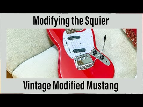

    I had one of these, modded it, took it apart, sold it in parts .
    Lovely guitar for the money, but I would upgrade to modern tuners. That's just me. The pickguard cracked fairly easily too, and the switches didn't work after a month. Well one of the switches. All easy fixes though.
    I have GAS for another one now. Lovely guitar to play. Nice and light, and comfortable.
    When I did take it apart, I was going to use the neck for a Squier Jaguar body, but it didn't fit the neck pocket. Not sure if that's normal with Squiers in that they have random measurements!
    I have seen one with a 24" aluminium neck. Must be neck dive city!
    You could also put in a hardtail conversion plate, or upgrade the springs in the tremolo. Have you seen this video (several videos, here's part 1):

    @Creed_Clicks that video embed is buggered - that happens when you edit your post and you have to embed it again
