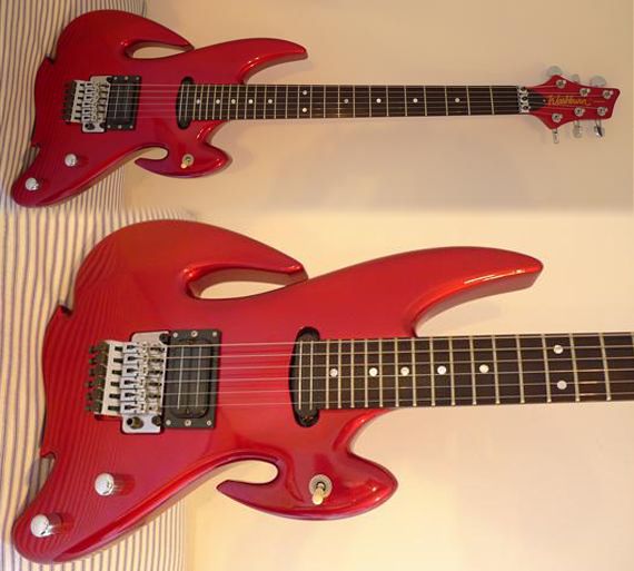

    I also remember seeing nuno playing the washburn prototype of this guitar at the Freddie Mercury tribute gig in 92
    Very cool to see a piccolo version being made,but id have loved to see it in a bright wacky color or maybe a pearl white
