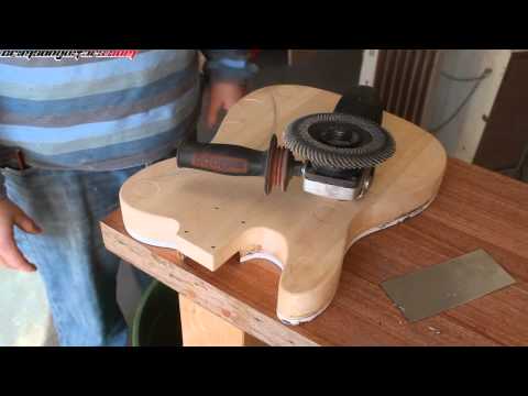

  • For the contouring I saw a great Crimson Guitars video where they used an angle grinder with a flap wheel and were able to very nicely 'carve' out the body contour.
    It's actually a video about improving a cheap kit guitar. About 5 minutes in you can see the technique used.
