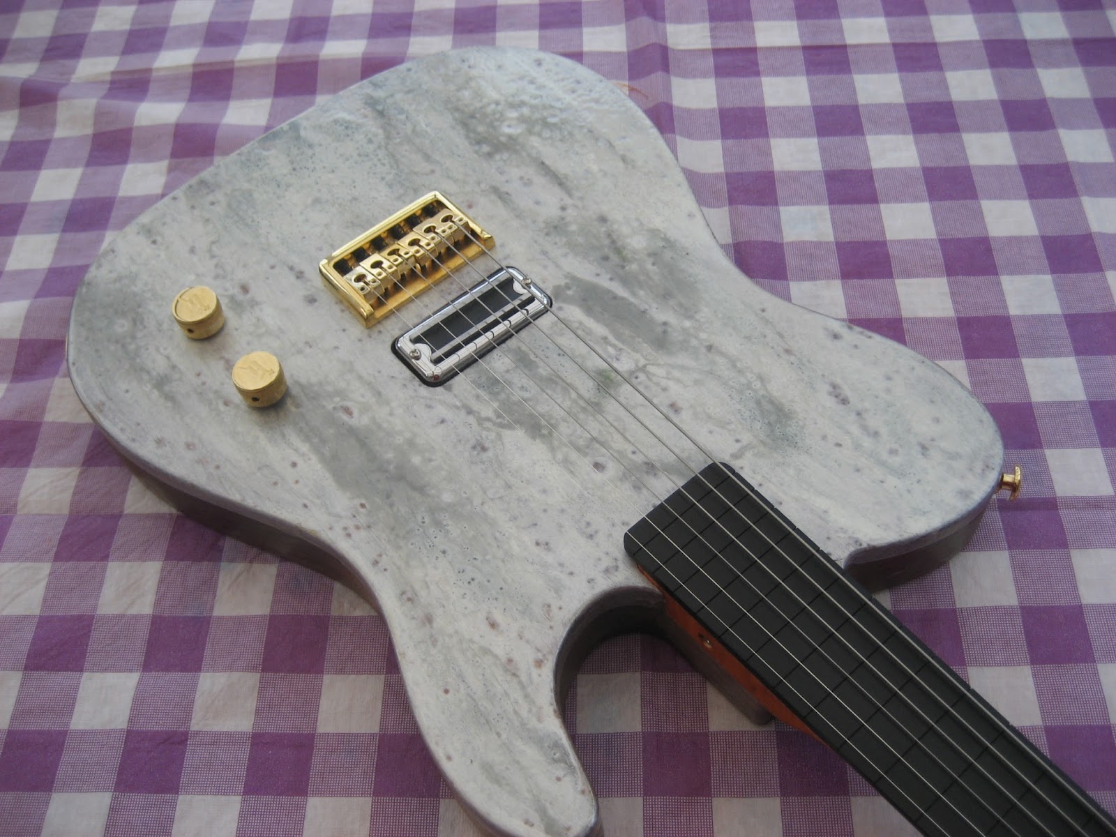

    Well, I've got strings on now - though there will probably be a few sets before I get it set-up right, but man it is fun to play.
    I've found that the best way to play it is to treat it as you would playing slide, but err, without a sliding thing (probably not the best approach but my brain works that way). Still got a way to go on getting the action lower, but it is down to 1.2mm all over which works well.
    I do keep finding myself playing things that sound like Ravi Shankar was a goth with a love of nursery rhymes, but it is definitely fun.
    The higher gain pickup is definitely needed and the previously unknown (to me) high gain settings on a Line 6 amp seem to suit it too, in overcoming the zero sustain. Just wish I could remember not to bend strings, stupid habit that one.
    Still got a few things to do - scratchplate, replace the string tree with one of those bar things, get all the way thru three blind mice, but shouldn't take too much longer now.
    http://3.bp.blogspot.com/-DO3KBHTtySU/UuveFqKB11I/AAAAAAAAG00/2uWAdq2ZnZE/s1600/IMG_5254.JPG
    Finally finished this last week, and I have to say it is seriously cool to play. I went for 11 flatwounds in the end which work perfectly, the action is low (though could probably go lower for the fleet of finger) and the whole thing has a beautiful buzz about it, so sliding into notes can give a lovely sitar feel to it.
    I lost track of how many times I had to plane the 'board  and tweak the TR to get it exactly flat or how many nut blanks I got thru before I finally got it just right, but well worth the effort.
    I went for a high output pickup, which helps on the sustain front, and not being a rock player, some big reverbs and a touch of fuzz are just plain beautiful.
    http://1.bp.blogspot.com/-cRu5XHTXP_0/UzlEr1ItaVI/AAAAAAAAHFI/syxj4sHt4-s/s1600/IMG_5521.JPG
    http://4.bp.blogspot.com/-_IfO_jS6IYY/UzlEoy4QdtI/AAAAAAAAHFA/GwzKrhOiWqA/s1600/IMG_5519.JPG
    http://4.bp.blogspot.com/-ZwuujE9P1g4/UzlE1roJxRI/AAAAAAAAHFY/aqtwJVUvytY/s1600/IMG_5522.JPG
    http://2.bp.blogspot.com/-fdQdEnnRRZM/UzlFK7UoQDI/AAAAAAAAHF4/deX_J_bCztE/s1600/IMG_5526.JPG
    http://3.bp.blogspot.com/-GLWYWkTdiYc/UzlFF4jF8-I/AAAAAAAAHFs/8MJl6iyU0IU/s1600/IMG_5525.JPG

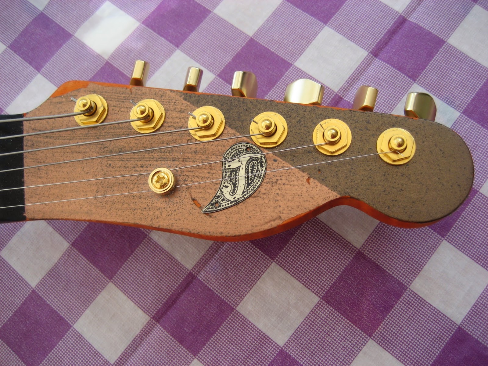

  • MegiiMegii Frets: 1670
    That is a stunner! I think the MOP finish is one of the nicest things I've seen on a guitar for a long while, and very individual. The headstock is great as well - I have to ask about the "J" plaque on there - how was that done? I might like to use something similar for some of my own parts builds.
    Very nicely done sir  -  that is one very COOL guitar   :)
    I would love to give that a try, what an interesting project !
    Cheers - glad you like it :) It is national walnut month...
    @Basher did me a Jooky logo, and I got the plates made by @CustomCoolEtch in Geordieland. They are basically etched on nickel silver by a very talented lady called Jane.
