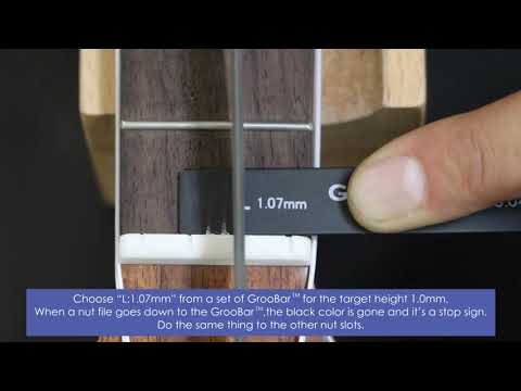

    Using a depth stop is a very good way to avoid cutting too deeply while minimising the number of times you have to file a bit, replace the string in the slot and check, then do another timorous pass before checking again. using feeler gauges as depth stops / step guides is a perfectly good way of achieving good results quickly and without too much fear of accidentally cutting too deeply.  For those that can afford the extra outlay, however, the Hosco "Groobar" depth stops (they call them "nut slot assist tools") are available in a range of thicknesses:
    I'm not convinced that the name should be "groobar", even though it is named as such by Hosco themselves.  If you look at the name on the tools there is a backslash joined to the uppercase B.  "Groove Bar" makes more sense than "Groo Bar", given that you are filing groov(e)s and not groos. My instinct tells me that it was originally named "GroovBar" by an English-speaking marketing chap and somebody created the logo using the backslash as the left upright of a V and the upright of the uppercase B as the right upright of a "V".  I'm sure that the "V" has been lost in translation.
