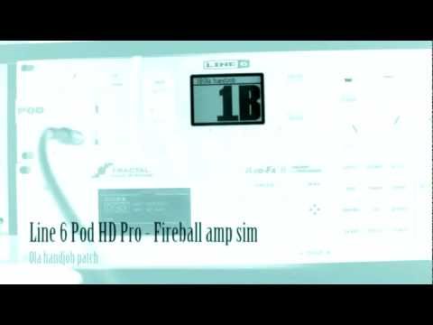

    Just gonna put these here for the metallers...
    Okay.. so they're pretty old... but it does tell you something... if you ignore price, ignore cult of personality, ignore brand names... and just listen to the sounds... make your own mind up. For me? The HD Pro has the better ENGL model, the Axe FX II had the better Recto model. The Axe ENGL has a very nasty high-frequency response that I don't dig, where as the Pod seemed more balanced. But the Pod Recto model sounded uber-flubby in the low end for some reason, whereas the Axe sounded more balanced.
    Similar story for this one:
    Point being... Line 6's HD amp modelling can keep up with the Axe FX II. I don't see why the HX modelling wont either.
