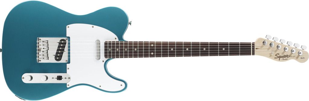

I've never modded any of the guitars Ive owned. I have a squire affinity tele - its way down the pecking order and probably has no sell on value (though is actually really nice to play!) so I figure it's the one to start experimenting on!!!
Firstly I'd like to change the pick guard - purely for cosmetic purposes - is this easy to do? Are replacements easy to find and fit?
Secondly I'd like to change the bridge from the style it is now (With five little string things - you can see I am a technical expert) to one with three string thingy's like you see on a Baja - purely cus it'll be easier to restring! Is this possible?
Ta people!

    The simple answer is Yes, it's very easy to do this.
    1 - Pickguard.
    Work out how many screw holes you have and start looking around.
    Allparts
    Richtone
    Scratch-It will make you a custom plate from a template of your original
    Google them to find what you like the look of.
    2 - The string thingys are called 'Saddles' and they sit in a 'Bridge'.
    At the moment you have SIX little string things, unless one has fallen off. This is known as a 'Modern Style' Bridge and the one you want is a 'Vintage Style' bridge which uses Three 'Saddles', each one carrying two strings at a time.
    Getting hold of one of these isn't difficult and as you play an Affinity Telecaster, you should have something called a 'Toploader' which means your strings don't go through the body to the back of the guitar, they should just go to the back of the bridge and be visible from the rear of the guitar whilst you're looking at the top of the guitar.
    This will help you in this case because if they went through the body as most of the Fender's do, you would maybe have problems with getting it all to line up.
    Still have a Tech do this for you though as new mounting holes will almost certainly be needed and the exact distance between the saddles and the nut (The slotty bit at the top) is called the 'Scale length' and your 'Intonation' (The thing that makes a fretted note above the 12th fret sound as in tune as the same note an octave below on either an open string or a fretted note below the 12th 'Octave' fret ) will be adversely affected if this isn't right, as if using a 3 saddle vintage style bridge isn't enough of an intonation problem (The thing that all the modern 'Unbelievers' keep harping on about !!!)
    So,
    You need to know
    How many screw holes your Scratch plate has and what style / colour / graphic design you would like
    and
    Look for a Top Loader vintage style bridge that preferably comes with 3 vintage style saddles.
    If you use Brass it will give you a warmer sound than what you have now.
    If you use Steel it will give you a more twangy, thumpy sound
    Also, your electronics won't be giving you the best that your guitar could give - there are plenty of options. My personal favourite and what i have in my Telecaster are from Oil City. The man responsible for these works of art is called 'Ash' and he is a member here
    you can find his website on google.
    Also, among others, is MOJO pickups who very kindly have supplied pickups for some of the builds our forum members have completed and again, you will find their products excellent quality and very reasonable prices.
    If you go this far, do the new pickups some justice and have the Volume and Tone Pots (The twiddly bits the do the turny thing behind the knobs) replaced along with the jack socket (The Pluggy-In bit) and the Capacitor inside (The magical whizzy thing that only the highly skilled wizards know what they do or how they work). This all combined will give your guitar a whole new sound, tone and life you never knew it had.
    If you really want to knock the bollocks out of it, take it to a tech for a Fret levelling and set up job. This will make the frets (The up and down lines) feel like glass under your fingers ( The Widdly, dancing spider bits) and make the strings (The left to right lines) resonate (Make noise) much better and feel so much easier to play.
    Your 'Nut' (The slotty bit at the top) will also be plastic and it will be holding back some of the tone you could be getting plus it will adversely affect your tuning, making it more difficult to keep tune after bending strings (Making it go "WAHHHHHHHHHHHH") so have the tech replace this with a bone nut. (This does not require you to donate some of your Own Bone - the tech should have some left over from the last person who asked him to put a Bigsby (The tremolo equivalent of a WW1 Bi Plane) on a stratocaster (The one guitar that was NEVER intended to wear such a piece of ****).
    You will probably then want to upgrade the tuners. (The turny-round bits at the very top that stick upwards like buttons on sticks).
    A good tech will be able to fit any decent aftermarket tuners for you. You need 6 in-line, right handed tuners and as long as you don't mind left over holes from the original ones on the back of your headstock (The bit at the very top that looks like a cock in a sock) then you can choose any style you like, within reason.
    I would wager that you could get a decent used Fender for the money you would spend doing this but that will only be standard parts on there and then you will still have to have the work done to that one so don't be afraid to do all this to an Affinity, although do be aware of you come to sell it, you won't get much more for it than you would if it was totally standard, just a fraction more because it plays and sounds really nice.
    I spent £1500 on my Baja, including buying it brand new but it's the perfect Telecaster for me and it will be with me for the rest of my life; In that way it was worth the investment to me but if i sold it, i couldn't ask for much more than about £500 as it will only ever be a Baja, albeit a really nice one.
    Best of luck and if you need any help as you go, there are plenty of people here who will help, including me.

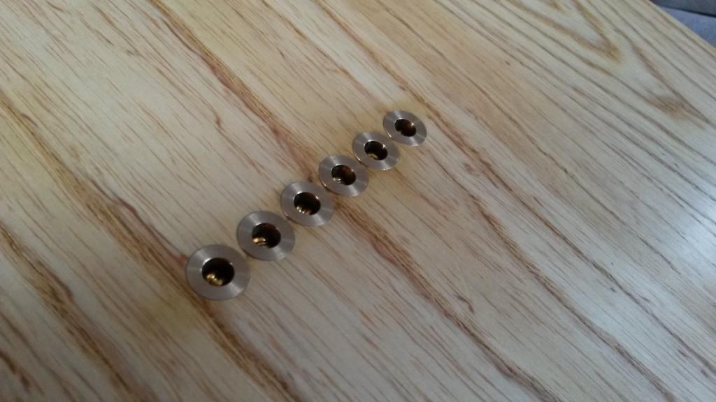

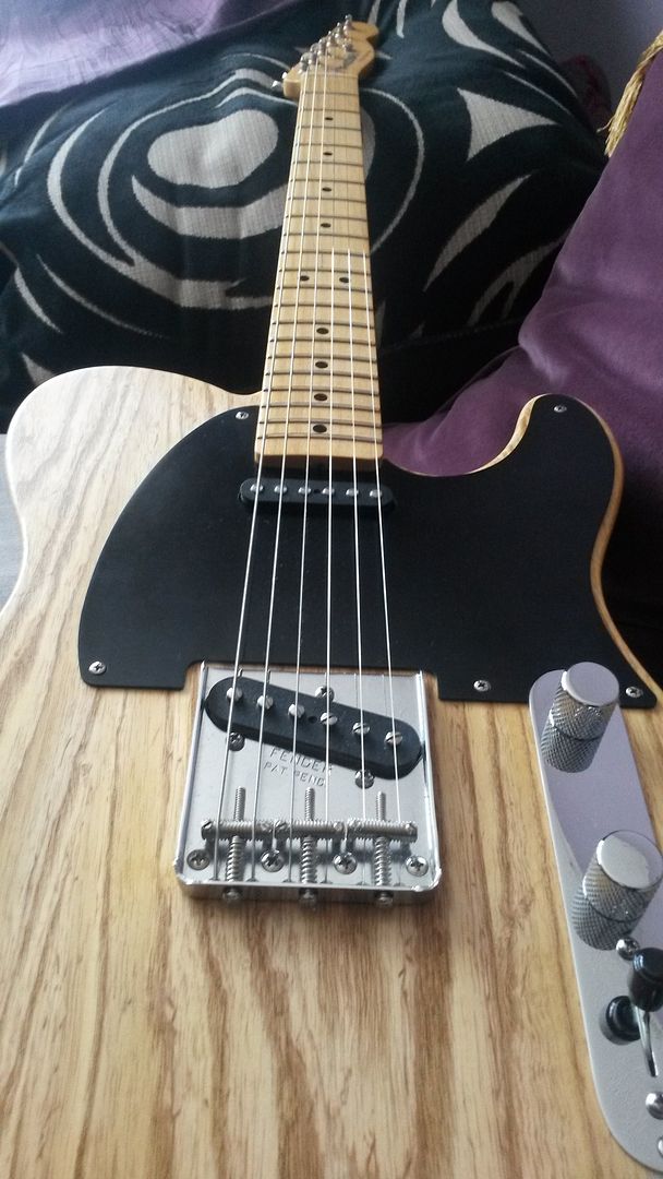

    I've since had the control plate put back to the correct way around and fitted strap-locks and this weekend a Heistercamp Leather Strap but that's it really.

    Jon has made the frets perfect and the resonance of the body has improved ten fold. The bone nut means no tuning issues at all and the action is just low enough to still be able to dig in when you want to.
    I fitted a Bakelite scratchplate from the American Vintage Re Issue 52 Tele which is a Fender Spare part from @RichtoneMusic and Ash from Oil City made me the pickups; A Californian neck pickup which is essentially a strat pickup built to fit in a Tele and an Alligator Bridge pickup which is a hybrid Ceramic magnet P90 in a single coil size unit.
    On the bridge position it growls like fuck until you turn the volume down a bit then it cleans up to be a well behaved twangy thing and on the neck it's as close to a strat as you can get a Tele to be but turn the tone down just a touch and it's almost back to being a Tele again. In the middle it's something quite unique but again, it's all so interactive with the volume and tone, there's a lot to get out of it.
    It's a medium weight guitar and now it has straplocks and a decent strap it's a joy to have round your neck.
    It's one of the few Tele's i've ever had that can do almost anything and whilst it's not ever going to give the power of a Les Paul, it's got enough growl to play most rock songs should you want to.
    The set up on the neck has meant you can play the top end of the neck without any problems and as it's a 9 1/2" Radius it's comfortable to bend notes anywhere. The Soft V Profile isn't to everyone's taste, it is to mine though as my first ever Fender Strat had a V neck and to me, that's where Fenders begin and end.
    It's a solid rock n roll guitar but ask it to play something delicate and it will do happily (Sometimes without me !).

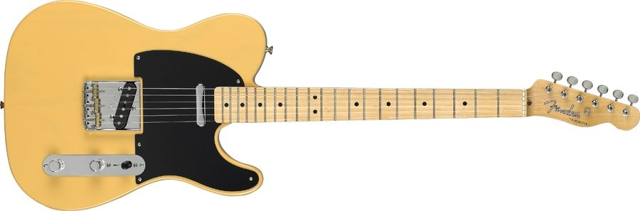

  • Fitting the bridge will require new mounting holes and will leave the old holes exposed behind the bridge as the Affinity bridge is a bit longer than a vintage one.
    A better solution if you can do this might be to drill the existing bridge to accept three saddle intonation screws.
    Ah - thats really helpful. It sounds like a bit more that I can manage then. I wouldn't even begin to know how to drill in the existing bridge or have the equipment to do it.
    Guess it'll just be a change of scratch guard then : (
  • Sorry but do check first that a standard one will fit. Here http://pickguards.us/pricetele.html they require a tracing for Affinity Telecasters.
    Here is the bridge problem illustrated
