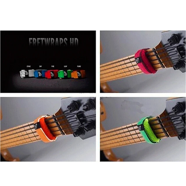

I was thinking maybe something like a velcro strap around the fingerboard, like those ones people use for doing tapping on electrics
  • FuengiFuengi Frets: 2850
    I'd imagine that some sort of soft cloth stuffed between the strings and fret board will suffice?
  • Gruv Gear Fret Wrap

    Fret wraps work fairly well, but if I wind an amp up loud I can still hear the acoustic guitars humming a bit.
    At that point I either put the guitars in a case or turn the amp down.
  • WhistlerWhistler Frets: 322
    edited April 2019
    Fret wraps cover just one spot. I would be inclined to slide a duster between the fretboard and strings to damp them over as much of the length of the fretboard as you can.
