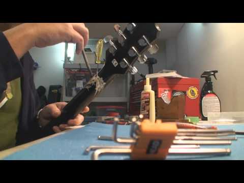

this split seems the same but mine doesnt open that far..
syringe it in ?
now I gotta buy some tightbond.
thanks Jooky.
2 clamps etc.
Very similar to your problem. Hope it helps.
What I thought would be an easy fix is baffling me.
So super strength epoxy, warm, spread break, work in epoxy.. Clamp.
I'm gonna dry run the clamps first to angle it so it sits in the biggest lip.
Also in gonna mask off the neck with electrical tape to catch any drip.
I take it the key is to not over tighten the clamps so all the epoxy doesn't ooze out?
