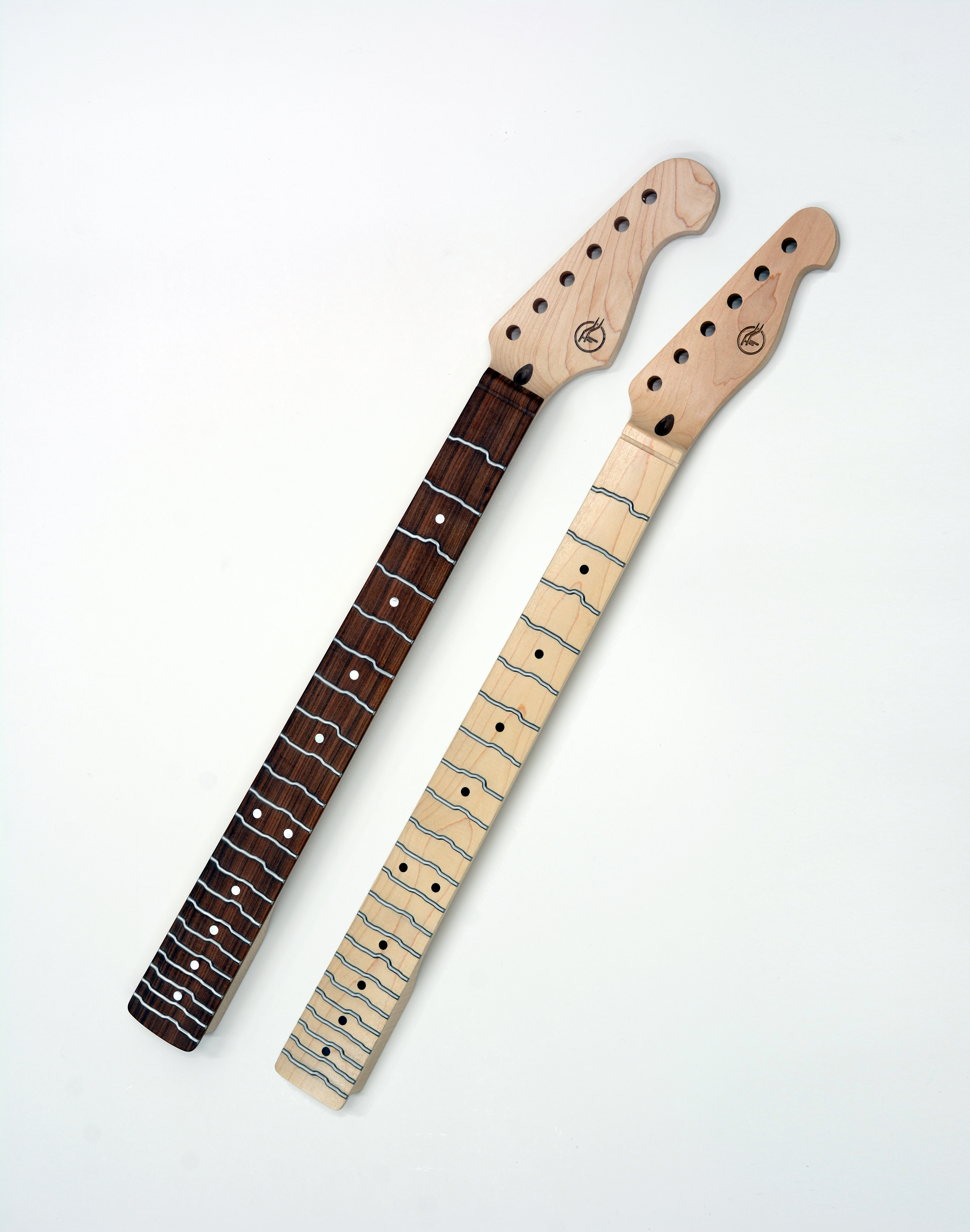

    Intonation is always a compromise on standard guitars, it can never be intune at every fret.
  • GuyBodenGuyBoden Frets: 744
    There is always "Just Intonation" if you want to be really "in tune", instead of using the popular equal temperament, which just divides the octave into 12 equal parts. ;)
    "In music, just intonation or pure intonation is the tuning of musical intervals as whole number ratios (such as 3:2 or 4:3) of frequencies. An interval tuned in this way is said to be pure, and is called a just interval."
    edited February 2023
    But if you use just intonation, your guitar will only be in tune in one key...
    :+1:
  • vizviz Frets: 10699
    It’ll be pretty good in the 4th and 5th keys - especially the 5th because only the dim 5 of that will be out. So if you tune to Just E, then B major will be fine.
    But yes.
