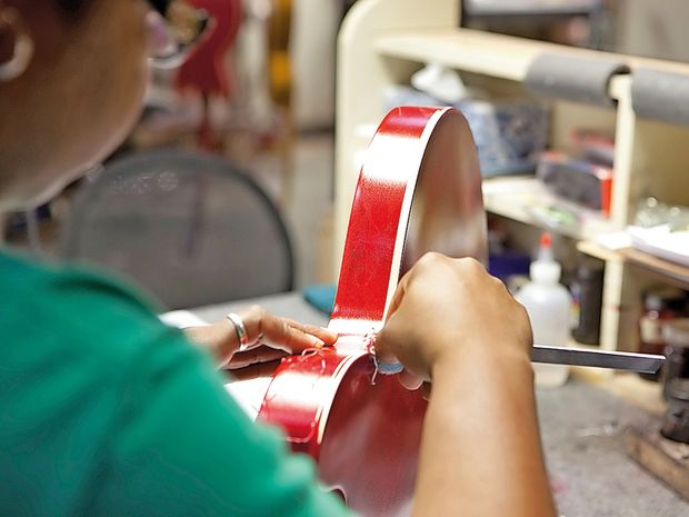

    Binding it hard work. I need a blade that's adjustable in length to a very precise length so I can set it, rest it on the body and scrape the binding accurately.

  • WezVWezV Frets: 17462
    I just hold the blade very close so my thumb guides it round.  this works best for me as there is little chance of my thumb scracthing the paint the way a hard tool could.  When scraping the thin top edge of the binding I angle the blade, it helps stop it going too far, but also gives a softer edge to the guitar
    whenever i said "whatever is closest" i meant literally whatever is closest to my hand, not what gives the closest adjustable length
    i control the length if the cut with my grip, i use the blade without any handle
    this is someone doing it at gibson - its just a long flat metal bar
